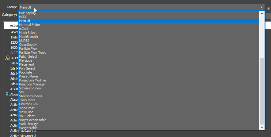

I may have read through the initial idea a bit too quickly and I wonder if you could give a bit more context behind the use case you outlined with Editable Poly->Bridge command? When you say that you have to set up multiple shortcuts depending on if you are in edge or face mode, for example, I get a bit lost. I'm only seeing one bridge command in the Editable Poly context. In addition, 3ds Max. In addition, I'm not sure I understand the core of your proposal versus what 3ds Max offers in the product today. Today, you can set up "Control+B" to do one command when in editable poly, and use the same "Control+B" in material editor for a totally different command.
dswahn
Perhaps I can add some input here.
I have always found that commands are context sensitive in relation to what "Group" they are assigned to. Maybe there could be some way to manipulate "Group" for commands.
I have always felt that when defining Macroscript, it would be extremely useful to be able to define "Group" even for scripts, but I guess that is a different request.
