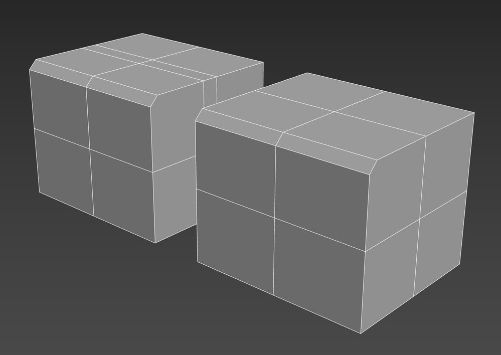

The EditPoly's Chamfer-tool works on corner edges AND edges on a flat surface. Unfortunately the Chamfer-modifier does not do the latter - edges on flat surfaces are not affected. That must be changed!
Illustration:
Two cubes with selected both: corner-edges and an edge-loop on flat surfacesTwo cubes with selected both: corner-edges and an edge-loop on flat surfacesLeft cube: Chamfer-tool  |  right cube: Chamfer-modifierLeft cube: Chamfer-tool | right cube: Chamfer-modifier

Hi.
It does, down at the button in the chamfer modifier list is the option "Filter by" just turn off Min. Angle, or lower it.
oliver
Oh, nice! Would have been a good idea to have the same defaults in both Chamfers but...
Thanks for this!
Chamfer Mod has a "Min Angle" option that is on by default which stops the chamfer from being applied to edges who have neighboring faces less than the angle number specified (default in Chamfer mod is 20). Turning off this option gives the result that you seek. If you want this behavior to be default, you can use the Chamfer modifier UI to create a new default preset.
