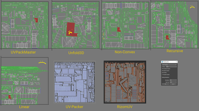

dmitriy.shpilevoy
@gandhics
Really? Maybe in your testcase it is, but for me native linear is absolute worst.
I'm using current version - 2024.2
Unfold3d is simply unusable for me at the moment. Here is an example - I need to pack existing shells to maximize UV space usage. It should keep relative size of shells, but I just can't find a way to do this with Unfold method. It always scales shells, doesn't matter what I pick in settings (normalize on scaling off, normalize off scaling on, both on, both off)
All native packing methods use same settings shown here.
UV-Packer is a decent solution. Doesn't do well with curved shells, precision sometimes off.
RizomUV does a good job on packing, my only concern is padding seems to be quite inconsistent and I need to throw UVs back and forth between max and Rizom which is inconvenient.
