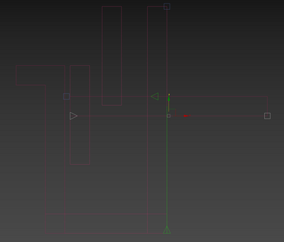

Mr.Mxyzptlk
Even a minor display upgrade would be welcomed. Maybe when selected it brings it to the top. As you can see here I have it selected and it's not showing over the spline. Meanwhile randomly, the non selected one is showing. Everything is at zero on Z.
