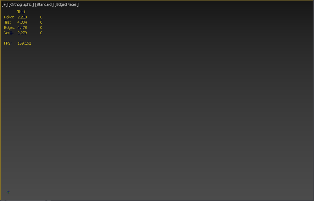

I have been trying to figure out what the problem with my view cube is a for a few hours now. It was fine when I touched it earlier, but suddenly it and the scene in the viewport wants to disappear. I noticed my scene would appear again if I switched the camera to a top/bottom/left/right view, but as soon as I tried to rotate the view cube again, I still have the same problem. When I view all four windows at once, one or two windows will let me select and rotate the cube normally, but as soon as I full-screen that window and touch the view cube, it does the same thing.

The viewcube seems to cause problems for a number of people.  When you say your scene disappears... is the camera view moving far away from it or are the objects there but invisible?
Can you try to disable the viewcube for me?   Once you do, does the problem with disappearing go away then?  Thanks for trying that!

There are two issues that exist and I'm not sure which one you are experiencing.  I'm seeing a lot of reports of objects becoming invisible in the viewports for some people.  In that case you can still see the outline of objects when you select them, but they are invisible.  It seems to have to do with drivers and that is being investigated and followed up on as we type to one another.  Trying DX9 or older drivers should help with it for the time being.
The other is related to the viewcube or possibly objects that are in the wrong system units or are very far from the origin at 0,0,0. Disabling the viewcube usually solves this issue.  The grid disappearing too makes me think it's this issue.  I should ask, how many system units across is your scene?  Is it far from the origin?  If it's less than say 5000 system units across and near the origin, disabling the viewcube should do it.  Thanks for trying those things and I'm here for you if you have any questions.

I got to the bottom of the first issue and it was actually a result of objects that existed millions of units from the origin.  So in that case they both come down to system units.  A few feet from the origin is no problem usually.

Opening the scene explorer allows you to select any object of the scene, and you can use the top down button "zoom extents all selected" to put again on sight your objects... (hovewer using the view cube will make the problem appear again)
One "fix" I luckily found, was to create (or load) a previous save of the project, and then use this as a base/host to the bugged project save merging both together.. this "transfer" the objects (at least the modelling, bones and materials) , not sure about other things... into the project, but THE BUG NO LONGER APPEARS... what allows you to re-save it and continue working normally.
