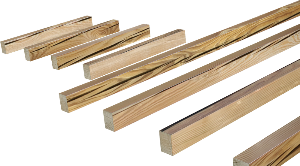

I have finally undertaken the task of not just using seamless textures with a standard UVW Box Map, but 3DS's more precise UV Unwrap modifier to hopefully achieve for more precise (and crisp) results.
My problem, simply put is that the UV Unwrap modifier seems to be inconsistent with how it scales it's 0-1 UV canvas, per object, and I would like (if possible) to increase the map density while keeping the mesh within the confines of the UV canvas so that I can effectively output a UV canvas to Photoshop for some texture fitting. Allow me to give you an example that has had me scratching my head all day.
As you can see below, I successfully unwrapped a simple timber column and was able to composite a wonderful Photoshop texture right back on to it with stunning resolution (I actually got giddy doing this- especially since the rendering times were significantly shorter than my usual composite map renders!):TimberColumn_Settings.png
TimberColumns_Example.pngGiven my (relative) success, I decided to repeat this technique, but with a few more instances of geometry to save time and precious sanity. This was attempted with some exposed rafters and found that, despite the canvas and UV template maps being the same size, the texture performance (despite me providing a 4096x4096 @ 300 dpi) map, I received poor viewport and rendering performance:

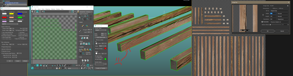

I then questioned if my map was too small as I had an overkill 2K map on a single object vs. a 4k map on several objects. After watching a few videos on the subject, I discovered a handy little plugin called "TexTools" to view my UV scale (as a checkerboard) to gain a sense of the UV scale for my object, and what I got was surprising:
It seems the density of each object is significantly lower-- likely because there are more objects to cover in the same UV canvas. Despite what I learned from other videos no matter how I packed my UV's or AI upscaled my Diffuse map from Photoshop (I stopped at 8K with similar results), the only thing that reduced the density of my UV's was to overscale the mesh outside of the 0-1 UV canvas, but then you need to rework your UV Template as the meshes have moved (EDIT: you can't render the UV Template as nothing is within the 0-1 space..).
So to summarize, is there a way to increase the relative scale of UV intensity within this canvas, or am I best to work on a smaller set of objects, as with the column above and bake them all down at a later stage?

4096 x 4096 @ 300dpi is equal to 983 x 983 @ 72dpi which is what monitors use.  So, you want 4096 x 4096 @ 72dpi here most likely.  The post is pretty long so maybe I'm missing something, but that's the first problem right there.  Start with that and probably the problem is resolved.

I would recommend you to explore the use of UDIMs. That is what use when I need to texture large areas
https://www.youtube.com/watch?v=DmuHLe6MjEA
I am not sure if Photoshop is going to help you with that, so you probably also want to check something like Substance Painter or even Mari (has a free version) to do this kind of work.

8k textures for some wood is overkill most likely.  You might be under the impression that more resolution means more quality but that's not always the case.  The lighting itself will add details based on your bumps and smoothness maps that is outside the texture itself.  I would make them 4k maps @ 72dpi and see how it looks.  But remember, you don't need more res than whatever your display device is capable of displaying at a specific size on screen.   As far as UDIM, I don't use it much so I'm not the best person to suggest there.  I will agree that substance painter is 1000x better than Photoshop though.  I don't even use Photoshop anymore outside of tone mapping EXR's, and even that I'm starting to use Affinity more and more.
