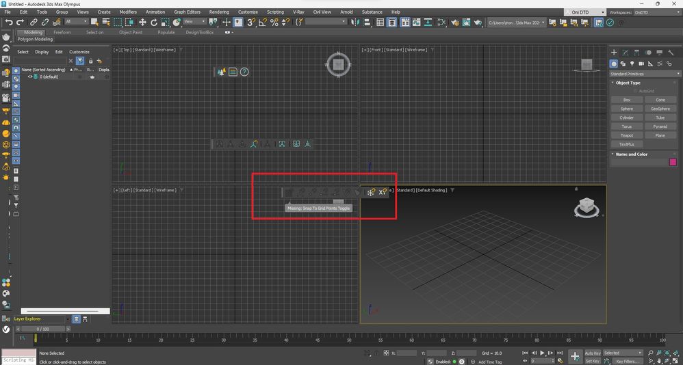

For reasons unknown my Snap toolbar has become missing. Toggle buttons are missing. This happens when i drag the Snap Working Pivot Tool toolbar out with  Snap toolbar.Screenshot 2023-04-17 204614.jpg

Sorry my english is not good, maybe you don't understand what i mean. Here, snap toolbar buttons are missing.
