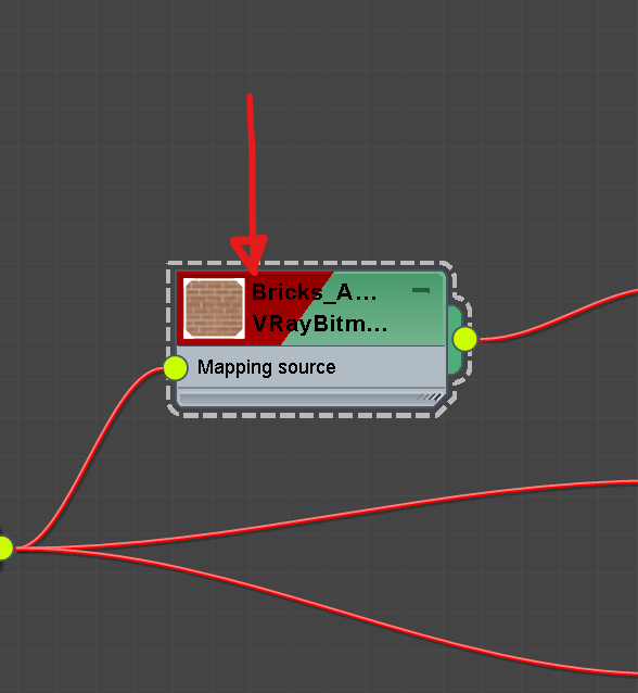

in addition to this problem I'd like to add that in 2024 SME the red stripes that indicated which texture/material node is selected for viewing in the viewport are not present! It is a convenience I'd like to see again in the SME.
The attached image shows what the nodes looked like in 2022 SME.

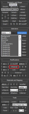

Just wanted to say that besides the slow process of right-clicking the node and 'show material in viewport' on each node, there is always the main Menu -> View -> Show Materials in viewport as -> [Options].
If that still doesn't work, there is a very handy button on the STR Tools Script that will turn on/off all Materials in the viewport:
https://www.scriptspot.com/3ds-max/scripts/strtools
