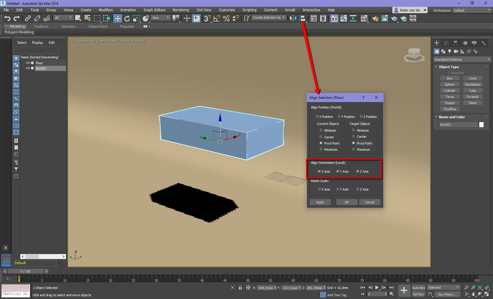

I'm not fully sure on what you want, but i hope i'm guessing correctly.
To rotate objects you can change the "reference coordinate system" to suit your need, so maybe that could be an easy option:
There is also the "align" function, with which you can also set orientation:
Does either of those options help?

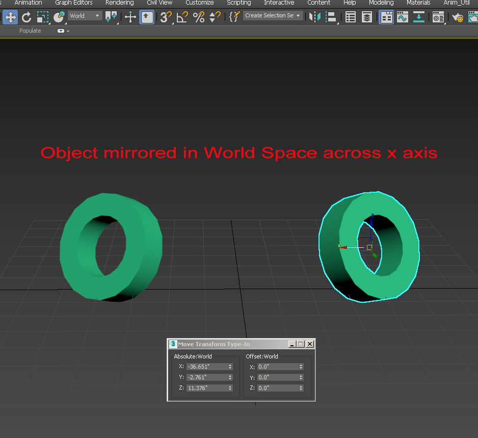

10DSpace
@Anonymous
Symmetry is a modifier  and this is a different case than your first question which was how to align an object in world space.  Symmetry is relative to the pivot point of the object.   If you want to change the orientation or position of the Symmetry modifier gizmo you can so by directly manipulating it as you seem to have found out.  But you cannot use the spinners in the transform dialogue to zero out the world orientation of the symmetry modifier (as you have also found out. )    And symmetry is really intended for use in duplicating 1 side of an object like a character so you only have to model 1 side and the other side is automatically updated.
If you want to duplicate a whole object with symmetry in World Space, a much better choice is Mirror (see below).   I think this is what you are trying to do based on your post.
Message 9 of 17
