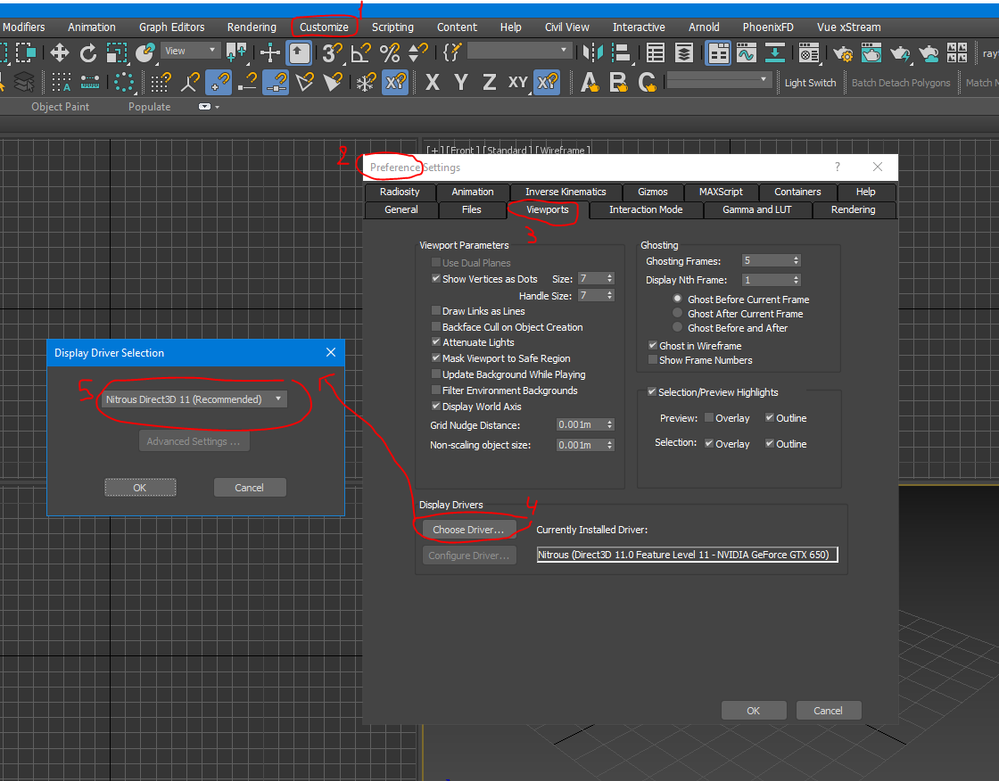

miledrizk
Maybe, but not sure, you need to update your Graphics Card's driver,
So maybe you should try that by going to the vendor website and check for updates.
But before updating, we can try changing the Graphics Mode to be sure that it's a Video Card Driver issue:
Go to Customize menu, Preferences, Viewports tab, and click the Choose Driver button
From the drop-down menu choose a different option than the current one, click Ok and restart Max.
If this also doesn't solve the issue set it back to the Recommended option.
If it works, then like I suggested, try updating your video card driver when you have time.
