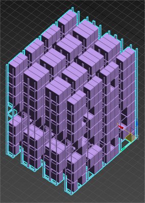

First of all: Thank you.
This works perfectly for a single shelf.
But now I'm encountering another problem:
The Screenshot shows a high bay warehouse racking, created with my tool. It is fully procedural. the amount of boxes in each compartment depends on the size of the compartment and the spacing between the boxes. The amount of compartments depends on the size of each one and the overall size of the warehouse. But as you can see, if I duplicate them with the CloneAndTrasnform compound the shelves look exactly the same. I think I already know why this happens: the compound uses the "baked" result of the function (the TriMesh) but not the function itself. But i haven't found a workaround for this problem yet.
Message 4 of 15
Swordslayer
That's what you get by using cloning... A clean way would be generating the transforms in all three dimensions first, filter that result, then place meshes at those transforms and output final mesh. Dirty way would be filtering the resulting elements after cloning in all three dimensions (not before the last step as you do now).

Finally after some days of trial and error, but more important, lots of help from here and that facebook group, I was finally able to get a solution to this problem. The source of the error was the MeshElements node, because, as it seems, this isnt able to take more than ~3800 elements at once. solution to this: Splitting the whole Array of meshes into vertices, then slice the array by the amount of vertices in one object into subarrays. Then I'm using most of the script posted above to remove a certain percentage of objects and shuffle the array.
Picture below shows the whole process. The upper TriMesh input is the array, the other two are the base object.
