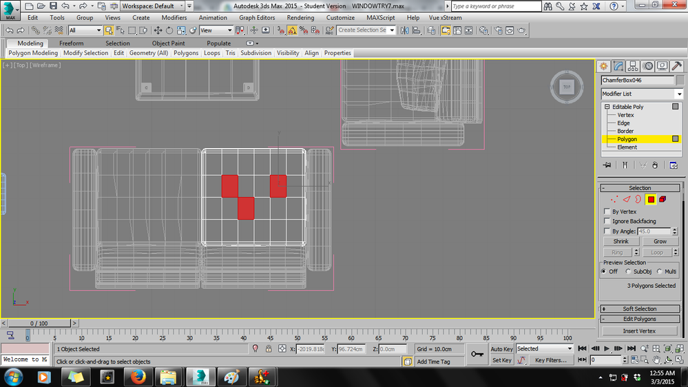

I was not able to get red poly selection with an edit poly sitting as a modifier above the chamferbox primitive. I managed to get them back, as seen in the pic here, by deleting that modifier and *converting* the chamferbox to an edit poly. However, I am thinking that there might be occasions when it could be advantageous to have edit poly as a modifier instead, and anyway, despite following the tutorial I am on, in which he definitely uses an edit poly modifier, his are red whereas mine are not (this happens for me whether or not there are any grey polygons in the display box over on the right).

Try a simple test in a new, clean scene. That should just work - and it does here every time I try it. The whole idea of modifiers is that you can, if you're careful, change stuff lower down the stack while preserving changes made in the modifier(s). I still recommened you try clearing your settings just in case.

With show end result turned off, and 3ds max reset as per the instructions on the link you gave me, that does indeed seem to have resolved the problem:
