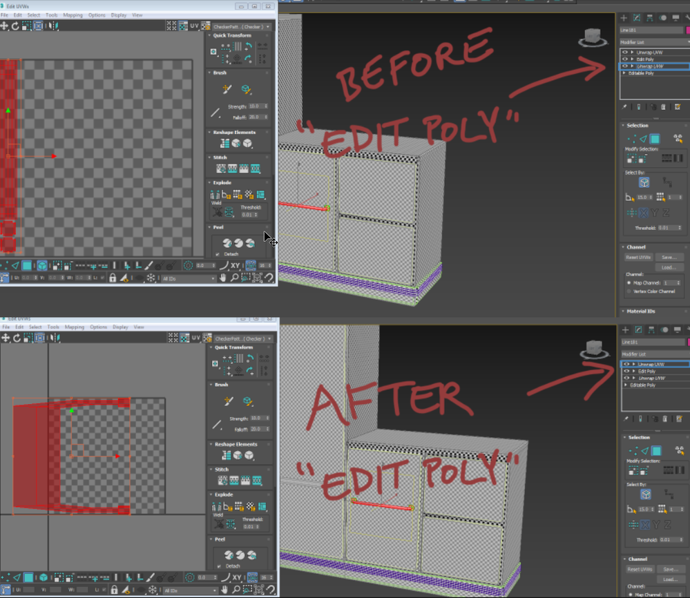

Unless I collapse my modifier stack after unwrapping uv's, an edit poly modifier will destroy any unwrapping i've done.
I've always thought this was normal until other max users told me they dont get this problem. Anyone know why this would happen?GKqJoW5

Hello @bksong and welcome to the community,
This is very strange.  I'd like to check the file if possible, it's hard to guess what is happening based on the screenshots.  Just to be thorough, do you have the latest service packs?
