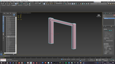

I have a scene with an object that I was working on with two elements in it. I selected one of the elements (using element select on 5 specifically) and then pressed 'hide unselected' to hide the other part so I could work on the part I selected. Trouble is, I now can't get the other hidden part back. It's definitely still there, because if I hit render, it appears in the render, but it seems completely un-selectable in the viewport.

EDIT: Screenshots of the problem:
Full scene, with all objects unhidden
Isolated object, with unhidden element shown in viewport
Isolated object, rendered to show hidden element

have you tried going to Editpoly  - element- and on the geometry tab hitting - Unhide All?
