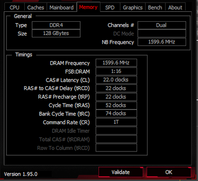

RobH2
I don't know if this helps but I'm posting tests I did with V-Ray Benchmark 5, latest one. It doesn't use Max but maybe it's a place to start to see if we can figure out what's causing the lag. A casual search indicated that my scores are pretty much average and expected. So, I don't see any sign of a bottleneck here.
