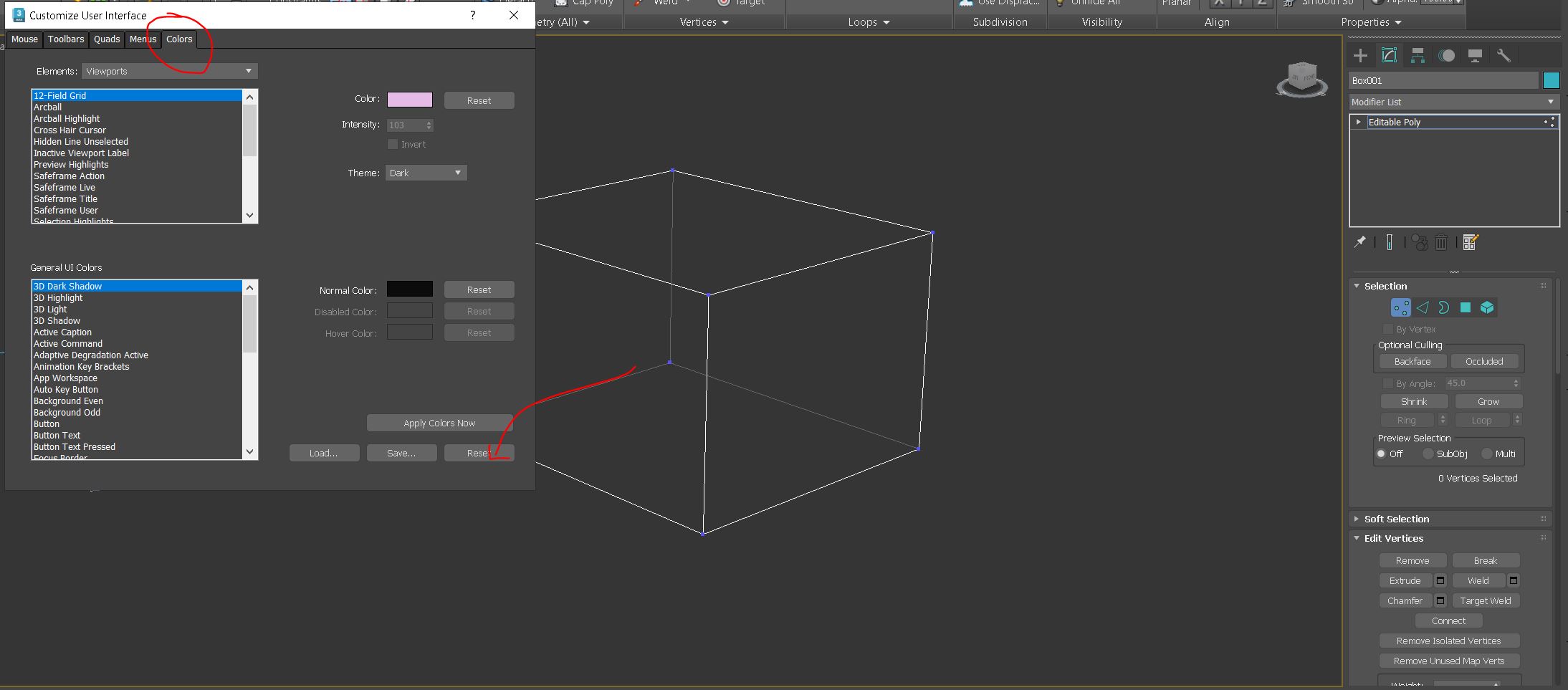

Figured out my issue.
The color for back face edges was changed to a gray color (very similar to the background......)
So I just reset all my colors to fix the issue. Not sure which specific setting you have to change.

reset colors on customize user interface
