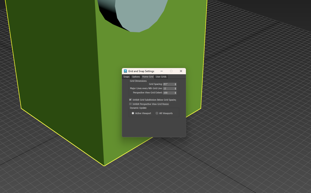

Is it true Max offers only ONE color for grid lines? Nowhere have I found the option to have separate colors for major and minor grid lines. I can't tell the difference between them with the same color! This seems like it would be an easy fix to an important issue.

spacefrog_
Yes, its true ... differentiation between major/minor only happens due to thickness
world axis gridlines are the thickest, than major gridlines somewhat heavier than the standard lines
BTW: major gridline intervall can be tweaked in GRid And Snap Settings->Home Grid

Thank you for responding to my message, frog. Here's a snippet of what I have. As you can see I have grid spacing set to every inch with a major line every 12. That way I can visually see where one foot measurement lies because the major Line should look different from the "standard" grid line. But as you can see in the snippet, all I have is one big grid and the assumption that those are 1" x 1" grids. There's got to be a way to change that. If you were in metric you might have a grid that is every cm and then a major gridline every 10 or 100 or whatever. If the differentiation is because of thickness, why isn't the 1 foot line thicker?Screenshot 2026-02-01 132421.png

Hello @ChadForeman74, thank you very much for your post. I understand that you are experiencing an issue when customizing the grid system in 3ds Max. I looked into the issue and would like to confirm: if you zoom further out in the viewport, are you able to see the major grid line every 12 grid units? Thank you.
