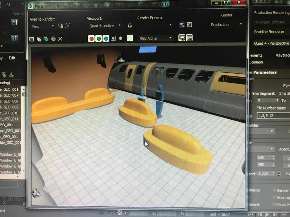

rendering solved.jpegSOLVED.. thanks alot @hagen.deloss
