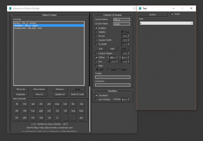

Alternatively, I just found this Interactive Rollout Builder. While it is not really what you're looking for, perhaps you could make some custom dialogue boxes that could be handy in some way. Certainly easier than butchering the main UI code anyways.
https://www.scriptspot.com/3ds-max/scripts/interactive-rollout-builder
