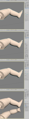

StephenMF
I too am running in to issues like this.
image 1 - straight import.
image 2 - With UVW added
image 3 - With an edit poly added - WORKS!?
image 4 - With a symetry added - NOT work!?
I suspect it has something to do with explicit normals vs. smoothing groups.
jasond240
Your issue there looks very similar to what I'm seeing. It's really frustrating.
