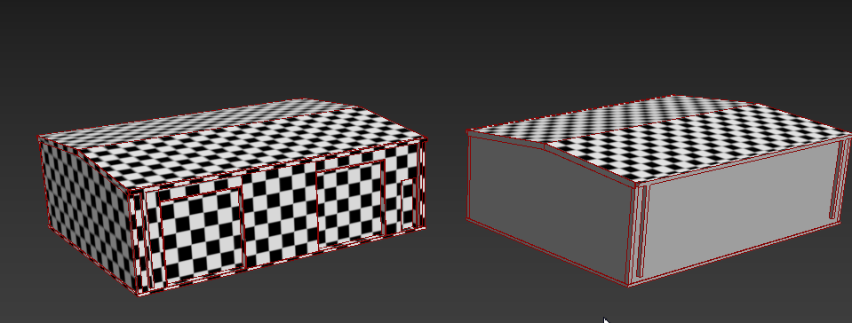

Hello, I am having trouble with creating a UV of a building I created in Sketchup and imported into 3ds Max 2018. It is my first UV so it looks like crap honestly but I am pretty sure it is not supposed to look like it does below. Some lines are somehow missing from some of the objects and thus they're black.
I also cant find out for the life of me how to turn it into a normal in Photoshop after I hopefully fix it.
For some reason these pics don't show up as they should, but the first one should be easily placed in PS if one has to so you can see.
Any help is appreciated,
Easton

PROH
Hi. I just posted this in your other thread:
Hi. Took a look at your Doghouse model, and there are some overlapping faces in it. You can see it if you turn on xView (Views -> xView -> Overlapping Faces).
If you click "Select Results" in the xView dialog roll-out, the faces will be selected. Some times you can then simply delete those faces, but in this case you got to do a manual clean up of your model.
PS - I think it could helps you to uncheck "Edges Only" in the object properties (select object and right click "object properties"), so you can see any crossing hidden edges.
Hope it helps

PROH
Hi again. I managed to clean up your Doghouse (file attached). The faces/polygons in the windows wasn't deleted, by other that it was an issue about retriangulating the hidden edges ((subobject level "edges" ->  activate "turn" and click on the edges). I think this deformation is happening during import, because of the way your model is made.
I know many people think SketchUp is fast when modelling, but a house like this is quite fast to model in 3dsMax too. Anyway, if you are going to use the models you make in SketchUp in other 3D-programs, you have to learn to model things in a way that transfers correct into those programs. Otherwise you'll spend more time cleaning up, than it takes to remodel the whole thing 🙂
Hope it helps

Alfred.DeFlaminis
Hello @Anonymous,
Ok I see what you mean about missing edges and weird UV's now.  All you need to do is collapse your stack and weld  your verts with a low tolerance of something like .001.  Then put your unwrap back on and you'll see the edges more clearly and properly.
Keep in mind that these UV's do have some overlapping which would cause problems in a texturing app like Substance or DDO.  You need to avoid overlapping UV's in most cases.  If I grab the big UV island in the lower left and move it, I see all kinds of things left behind in a strange manner.  (Overlap)
The double faces you were referencing may just be overlapping UV's, possibly because the object was mapped strangely.  You might want to take another stab at the UV's after welding those verts, but the main building model seems fine except for those verts that need to be welded.  Does that make sense?
Also, nice work @PROH, you went above an beyond here.  Good man.

PROH
Hi. It looks like there's still something wrong with the model. Wondering if it's something I overlooked, or if it happened during OBJ export. I'll see if I can take a look at it tomorrow.
- "Rats nest" mean "messed up mesh", and indicate there's something wrong - and there is.
- "All those lines" are edges. All mesh is build by triangles, and the edges of these triangles can be visible or hidden. To see hidden edges in Max, you select the object, right click, select "object properties, uncheck "edges only" and press "OK".
Hidden edges may look better in the viewport, but will often screw up in export - especially when exporting editable polys. Editable mesh usually keeps things as they are (but apparently not always).
I would strongly advise you to read up on the basics about mesh (vertices, edges, faces, polys and elements) + how to edit them in Max. Much of this applies to basic mesh in all 3D programs.

Alfred.DeFlaminis
Hello @Anonymous,
That's fair.  The link you posted is the right one for welding.  What I would do is select all the verts on your model, open the weld options and set the tolerance to .001 and then hit apply.  That should take care of the UV display issue.  Then, you might want to redo the UVs.  There are some quick mapping methods in 3ds Max, you could try flatten mapping or unfold mapping followed by a pack uv's.  (All simple to use even for a novice and please let me know if you have questions.)  As long as they don't overlap, DDO should be fine with them.
My experience with rats nests from Sketchup is that it's often easier to delete the offending faces and rebuild them with a quick bridge than try to debug them and fix them.  Looking at that screenshot on your model, I would just delete the faces and bridge.  Those flipped triangle faces are basically 'invalid geometry' created by Sketchup and as noted also called a 'rats nest'.
The lines became visible likely due to the welding of the verts in the model, but I'm only guessing.  I know it helped for the warehouse model you had.

PROH
Hi. Had a look at the "cleaned" model, and there were still some internal faces to delete.+ some errors in one of the windows. To stop the "rats nest" message, I also split the model in two pieces - the base and the house.
This will also make it easier to for example apply a shell modifier on the house, to give it some thickness. At the moment it has no thickness, and as a result, it's invisible from the backside (as seen on your previously uploaded picture).
I've tried to export it to OBJ-format and then import it back again, and I can't find a way to make this work without screwing up the model. However when exporting and importing back via the FBX-format everything works flawless. So might be an idea to use FBX instead of OBJ.
I've attached the cleaned model v 2 in both max-format and FBX-format.
Hope it helps
BTW - All the errors in the model that I've found, derives from the way it's build in SketchUp.....

Alfred.DeFlaminis
Hello @Anonymous,
When I use an STL check I can see you don't have double faces on the warehouse model, but you have a lot of open edges.  There are some 5+ sided polys on your model which normally should be cleaned up by cutting or subdividing.  This will create those lines on your UV's that you were asking about.  Generally speaking a 3D face should not be more than 4 sides and steps should be taken to prevent this.  The problem is working with a Sketchup model with bad geo isn't easy and most of the time as I mentioned I just rebuild the problem areas (or the whole thing).
The weld options are shown below.  I don't know what tolerance you used, but try something very small like .001.  I prefer to use Edit Poly for welding personally.  Your model probably imploded because you used too high of a tolerance.
Can you please try that for me?
The last issue is that parts of this model still don't have UV's.  You should check them with a checker map in a material or something to make sure you have UV's on everything before moving to texturing.

PROH
Hi. I think that the mentioned 3ds format is the actual .3ds format and NOT .max. *.3ds is an old format with a lot of limitations (i.e. maximum 8 characters naming, no instances). The "SketchUp reader" is most likely referring to a plugin that makes it possible to read/load SketchUp-files directly in for example 3dsMax, AutoCAD or other 3D-software. Today 3dsMax has this ability build in (IIRC), and that is in my opinion usually the best way to import SketchUp-files into Max.
Regarding the mesh "errors" I've found, then every convertion between formats brings a risk of some deformation, as I found the OBJ export and import did. But as I said, I think most of the errors derives from the way the model was build. I don't no any tuts or documentation that explains what not to do. I've learned it myself the hard way - by trial and error. Having said that, it is however easier to build and repair models, if you have a basic understanding of how a mesh is build (vertices, triangles/faces, polys etc. etc.), and that's why I suggested you to read up on this.
The way I found those errors, was first to use the xView functions, and after that I went manually through every part of the model. Quite time consuming, and therefore it's often faster to rebuild models in Max, or simply learn to model in Max. These errors doesn't only show in 3dsMax, but many program doesn't have the tools to fix them.
I won't be making a long step by step guide - it would be book sized 🙂
Hope it helps
BTW - I see that your proces includes several different programs, and unless there's a specific reason or purpose for this, I would personally chose a shorter route.
