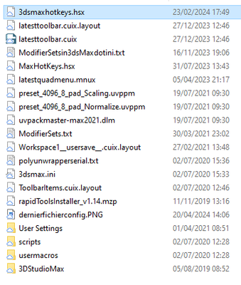

I hear you, it could be easier but it's not too difficult if you do it a certain way. You can just copy the '[ModifierSets]' section from the previous Max version and paste it to the bottom of the .ini file of the new version. Works pretty well.
I have posted what I do here and it only takes about 30-minutes to get up and running again with customizations from the previous version. https://forums.autodesk.com/t5/3ds-max-forum/migrating-from-2021-to-2022/m-p/10212988

Thanks! That's indeed handy to know about. Not automatic, but certainly better than manually running through the whole list of modifiers to add them to the button set.
BTW: Is this the .INI in the Users/App Data folder or the .INI under the Program Files/Autodesk/3DS Max folder?

It's in the ENU folder. Mine is:
"C:\Users\'yourUsernameHere'\AppData\Local\Autodesk\3dsMax\2025 - 64bit\ENU\3dsMax.ini"

I keep all config file I use on google drive in the same folder - when I upgrade to another version, I just do the same thing. I made a batch file that copies [Modifier Sets] from old file to the new one. I do the same for Photoshop, etc.
It's one reason I put off upgrading, although I've stream lined it a little bit now - would like to see just a simple single process to save all config into one file.
Beware copying old 3dsmax.ini directly over your new one - they are incompatible between versions.
