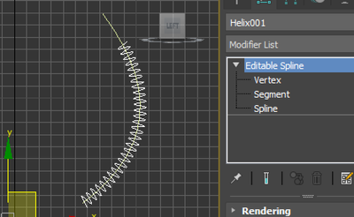

I performed a Path Deform Binding with a Helix, and the result was satisfactory. However, I now need to convert the output of the Path Deform Binding into an Editable Spline so that I can make some edits and add additional lines.
Is this possible? I've made several attempts, but every time I try to convert my Helix with Path Deform Binding, the Editable Spline ends up positioned before the Path Deform Binding, making it impossible to edit.
I want to edit the purple line. (See attachment.) 3ds Max 22
Thank you for your time,
Eduardo

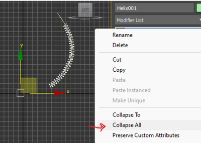

Instead of using the Path Deform WSM modifier use the Path Deform modifier.
Now right-click on Path Deform and select Collapse All
The result is an editable spline.
lee.minardi
designproduto
Thank you, that's exactly what I needed!
