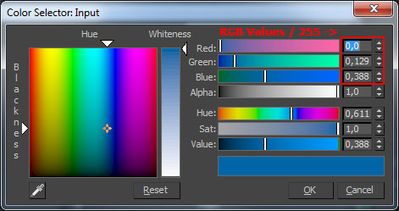

 Please read this post we made not long ago. Would be nice if autodesk can fix this and we can animate  color saturation by a factor of 1 and not 7
Link  https://render.otoy.com/forum/viewtopic.php?f=81&t=64187

You got an reply in the thread you linked, that's not how it works - legacy shaders support 8-bit RGBA values, i.e. four integer values from 0 to 255, hence the limits. You shouldn't use them if you want higher precision for any reason, use for example Arnold shaders, Vray color or anything else that supports floating point values:
