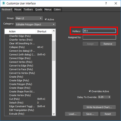

Hi.
Sorry for poor english 😞
I've been used 3dsMax for 10 years.
I'm using max2019 in Windows 10 now.
I assign keyboard shortcut Alt + C to Collapce in Editable Poly, and Shift + C to Cut.
But max2019 is working to Alt + C is Cut.
This is painful for me.
Another Bug.
When I run max2019 at first time, press Alt + any key is enable in Customize User Interface Hotkey: Input box.
But I using max2019 to working , max doesn't input Alt + "any key"
Max is very good program.
But  max have many bugs. many many bugs.. always.
Thank you for helping me

jiyoung.shin
Hi, @raiden_xavier
Thank you for fast reply.
2019.2 Update
I change ENU folder to ENU_old.
Max2019 is reset now
I assign Alt + C to collapse in Editable Poly.
But Alt + C execute Cut.
Message 4 of 10

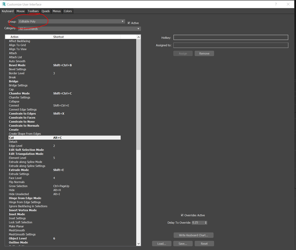

Hi @jiyoung.shin
The issue is caused by the fact that we have some unfortunate duplication of commands in both the MainUI group, as well as some of the editable poly/edit poly groups. As @Swordslayer mentionned, when you have "Keyboard Shortcuts Override Toggle" set to "on", then the shortcuts inside the Editable Poly group will take precedence over the MainUI shortcuts. You've only made your Collapse command shortcut change in MainUI, I am confident that if make it in the Editable Poly and Edit Poly groups then you'll get the the behavior you desire.EditablePoly.PNG
