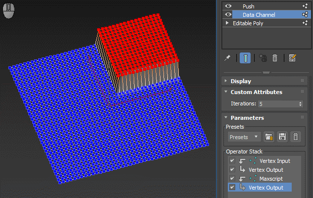

I checked it and it's actually a bit more involved to make it work in DCM - you cannot use Parameter Editor to add the parameters - well, you can, but in that case, just changing the parameters won't update the result. You'd have to add a notify call in the set handler of the attributes yourself, in that case it works (you can also see the attached file if you are curious).

Hi, at first I tried adding the custom attributes using the Parameter Editor, which felt like the most userfriendly way to add custom attributes. However, a parameter added this way didn't trigger an update when changed. This is what was happening:
You can tell that this goes against the interactivity everyone is used to with modifiers in max. So I made my own custom attributes where I added a call to notifyDependents whenever the parameter changes:

It looks the same way custom attributes generated by the Parameter Editor would look but there's the on numIters set line in addition. What it does is whenever the value of the iterations changes, it triggers an update of the selection of the dependents of the attributes (and since they are added to the Data Channel modifier, it gets that notification).

Yes, though as you can see, the modifier itself is not a parameter that's passed to the handler, yet there's still a way to access it (and by extension the attributes assigned to it). And as with scripted controllers, you can assign anything that's also accessible in global scope. Plus there are other things you can access via the polyMesh like vertex/edge/poly flags (there's for example a flag that tells you if the given subobject faces back or not in the current viewport) and so on. There's a lot that can be done with maxscript 🙂
