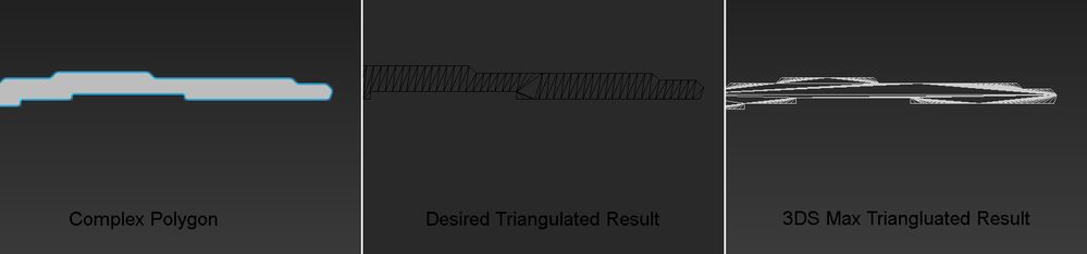

Hi all,
I'm hoping someone with more experience can help me with this.
I have a large complex polygon and I need it to be clever when triangulating but instead all it does is create a right mess.
This shape was imported as a DAE, attached all the geometry into one object and welded the verts together.
I have tried the following:
Triangulate modifier
Selecting all verts and connecting
Converting to patch then back to edit poly.
I have attached an image below that shows the desired result.
All methods lead to the mess you see below.
If anyone could help it would be much appreciated.

The reason you can't get the vertical line segments the way you want is because your geometry is lacking vertices along the long straight edges of your piece.

Thanks for the reply,
My apologies i should have been more clear, there are lots of vert.
Here is an updated image:

no, this is used to join two different terrains and the way it currently triangulates causes bad shading and is unusable.
It will then be used in a real time application.

Currently the triangulation is causing some of the polygons to have large crease angles so re-smoothing the shading makes it look worse.
Sub dividing keeps most of the same triangles that triangulating does then sub-divides those so the issue doesn't get fully resolved, plus the extra polygons are not an option either.

It's not a road... it's the joining of two terrain meshes. it's about 60km long and I'm looking for a quick way to do.
I've luckily found a quick way. I convert the border to a spline, delete the two ends so there are two separate segments then using the 'cross section' feature drag from one side to the other.
I had to split the whole section into about 10 or so sections but it worked well.
