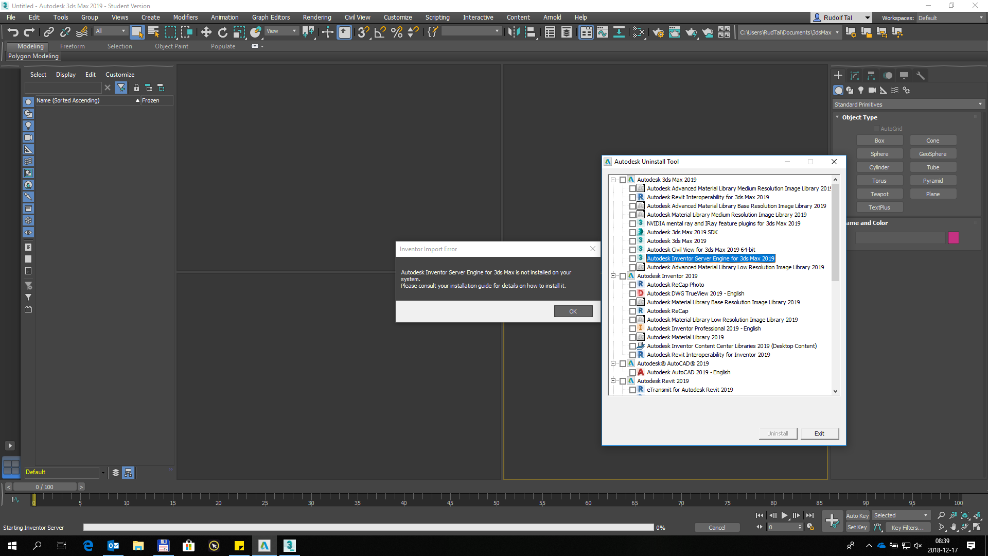

Im trying to import an Inventor file into 3DS Max 2019. But getting error that saying "Autodesk Inventor Server Engine for 3ds max is not installed on youre system".
Please advice.

Sorry to hear about that. Can you check something for me as a first step? If you go into your start menu, inside the Autodesk folder, and launch the Autodesk Uninstall Tool, do you see Autodesk Inventor Server for 3ds max 2019 installed?
Yes I have Autodesk Inventor Server for 3ds max 2019 installed

Hmm, ok so it may be a case of a corrupted installation of that component. Can you please try uninstalling Inventor Server for 3ds Max 2019 using the same autodesk uninstall tool, then re-lauching the main 3ds Max 2019 installer to reinstall that component again, fresh?
