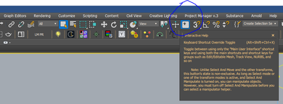

TomChad
It's on the top of 3ds Max UI:
Message 5 of 8
alexeyfenix
yes,he is on, but not working again.
