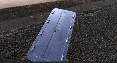

why is it happening, Ive tried everything I know
  • its NOT a UV problem
  • I have tried creating new materials and new texture files, nothing
  • I think, it all started when I changed a color profile. Right now it is set to "Unmanaged"

So far it seems to me that the problem is that you are bringing the maps into 3ds Max with the wrong color space. Everything that is scalar data, like bump, normal, roughness, displacements, needs to be set to RAW and not Automatic, which will turn is sRGB. Even if you don't use color management you need to set the gamma to 1.0 and not 2.2.
Before
After
Gamma needs to be set correctly
Before
After
