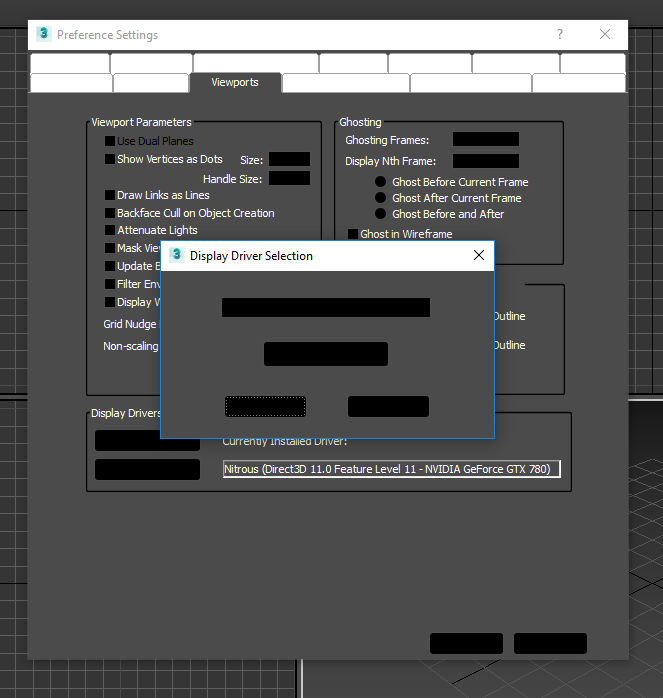

Hi all, I'm going crazy here and would love some support! I was doing a render yesterday and suddenly my 3ds Max has gone crazy!
All menu's, dropdowns, tabs, dialogues have gone completely black! Can't see a thing! I have reset the PC, I have re-installed graphics drivers, I have tried to reset the UI in Max but I can't see any of the options or tabs because they're blacked out.
I have run in Admin mode just in case, but nothing. I really don't want to uninstall because it is a nightmare to re-install all the plugins, and there must be a simpler way to fix this if it could just happen during a render session.
When I go into some menu's or settingsWhen I go into some menu's or settingsMain DisplayMain DisplayAll other applications work fine, and all other Autodesk applications are fine, only 3ds Max. I have attached a screenshot of the main UI for reference. Please help me! I'm right in the middle of a big project!
I'm running 3ds Max 2017, Windows 10 Pro
2x GTX 780 GPU's, 32 Gb RAM and an Intel Xeon 2.7Ghz Processor
I have the Nitrous drivers running, no changes have been made since installing and running 3ds Max without problems for a year now.

Thanks for the reply! I had seen that thread you mentioned before i posted, and i tried the suggestiin but nothing worked.
I have also manually checked the drivers for tge GPU and everything is fully up to date.
I cant figure this out! I an so frustrated!

Thank you so much!! Brilliant! No re-installation or anything necessary, just rename a file!
Fantastic!! Thank you!
