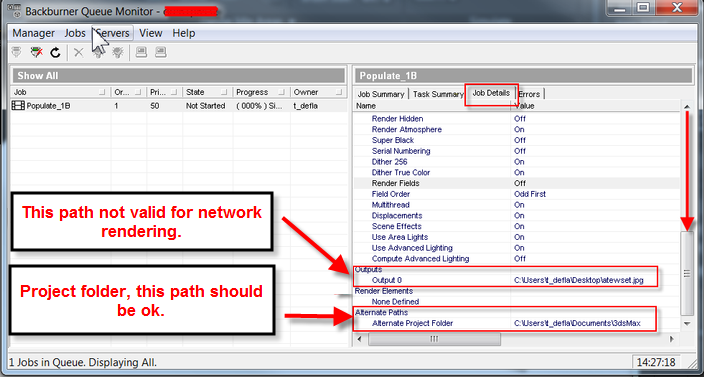

Hello @Anonymous,
In a general sense, it means that the location that backburner servers are trying to output frames to is invalid or they don't have permission to access it.  The most common reasons for this error are:
1) Saving to a desktop or something where C:/Users/Your User Name/...  doesn't actually exist for the render machines.
2) The location is a network drive but only you have access, or it's a network share that isn't the same for each machine.
3) Using a 3rd party renderer like Vray and having the Vray Frame Buffer pointed to the right place, but the "Save File" on the common tab set to an invalid location.  Some plugins may even enable the f10 Common tab File location by default.
You could try to check the output path of your backburner file by going to the following place in the monitor.

Hello @Anonymous,
You can change the path by pressing F10->Common Tab->Files.  By default it's gray until a path has been entered.  If you find that is the case for you, chances are that you may be using Vray or another 3rd party renderer, in which case the path is part of the Vray Frame Buffer dialogue.  (F10-Vray Tab-Frame Buffer)  Another thing that may be happening is some of the render elements have a manually entered path that is invalid.  I have a screenshot below that is hopefully more helpful.  Please let me know if you have any other questions, I am happy to help.

That's all well and good to change the path for something that is not on the network and accessible to all machines.
But the Alternate Path is automatic, howimage.png do you change that!
Message 6 of 19
Alfred.DeFlaminis
Hello @Anonymous and welcome to the community,
That's just your project folder.  Shouldn't stop anything from rendering or cause any problems.  You can change the project folder on the File menu, but usually not necessary.  Are you getting errors?  Which renderer are you using?  Perhaps that renderer has a custom output area (such as Vray Frame Buffer) where the path is incorrect.  Thanks for any extra information you can give me.
