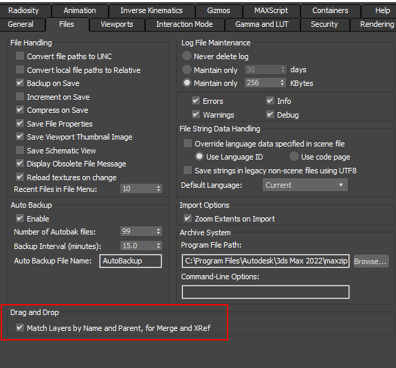

I installed 3ds max 2022 today and cannot get these settings to stick.
Every time I restart max, Improve Quality Progressively is on and anti-aliasing is off.
I've reset the *.ini file but still not working. Is this a bug?
Running win10 latest

Save UI configuration on Exit, cannot Save some preferences.
Can't save Selection/Preview Highlights.
Untilt Drag and Drop, and shows tiled after restart.
Grid and Snap Settings also
let me know if you have some way to solve it.

kossatz
Do you guys have V-Ray installed?
There is a bug in 2022 that prohibits the changes made in the preferences and settings. To check, please uninstall V-Ray for Max and try again.
The selection preview/highlight issue is fixed this way on our machines. Though we can not render without V-Ray, so something has to be done to avoid this.
Message 10 of 43
daniel
I am using V-Ray, will try uninstalling.
Uninstalling V-Ray did the trick, but is no useful solution in my case. Let's hope Autodesk or Chaos Group will quickly release a fix .

Hi @kossatz and everyone,
Okay, I checked on this issue with our developers, and this is a known issue that should be fixed in an upcoming update. What can happen is, a plugin can trigger a "silent crash" when 3ds Max closes which can prevent the last settings/preferences from being saved. We're in contact with the plugin manufacturers to try to ensure this doesn't happen in the future, so I just wanted to make sure people were aware. Thanks!

Hello @kossatz , @Anonymous , @Kreaction , @daniel and @Diffus3d ,
We've been working with Chaos Group to resolve this issue from both the 3ds Max and the V-Ray side, and hope to have a permanent fix for this shortly. In the meantime, please try the following:
  1. Download the attached .zip file, unzip the MAXScript within and copy it to your 3ds Max 2022 \Scripts\Startup folder.
  2. After launching 3ds Max 2022 and making various UI customizations, this script should prevent plugin Qt code from resetting various preferences upon the close of 3ds Max.
Please let us know if this works!
