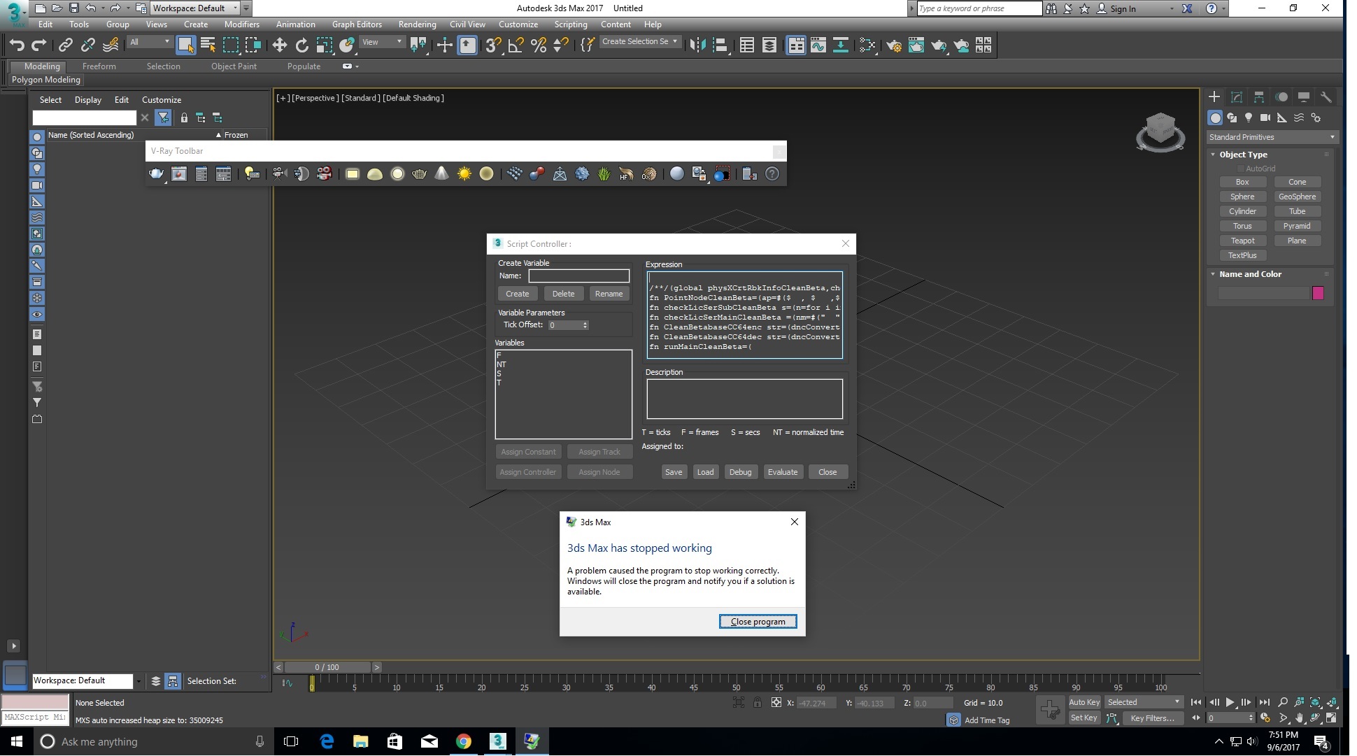

itEZQZ2
AFTER  UPDATE    OF   3dsMax   ( INSTALL  PATCH NAME   2017.2_Update )   TO 3DAMX 2017
THEN UPDATE  WINDOW 10
 OPEN  3DMAX  2017  THEN   CANNOT  USE    3DMAX 2017    IT'S  SHOW script controller AND SHOW STOPPED WORKING
 I HAD
UNINSTALL  PROGRAM 3DMAX 2017 AND  WINDOW  -->   RUN -->    REGEDIT   THEN  DELETE  FOLDER   AUTODESK
UNINSTALL MS VC+++
UPDATE  WINDOW 10 VERSION 1703  TILL  6 SEP 2017
INSTALL 3DAMX 2017  NEW
AND OPEN  3DMAX  SOME FILES  CAN  OPEN AND  THEN RENDER  IT'S  OK   AFTER THAT
I  OPEN  NEW PROGRAM 3DMAX  AFGAIN    IT'S  ERROR    ---> SHOW script controller AND SHOW STOPPED WORKING
I TRIED
I HAD CHANGED   PATH  3dsMax  TO OLD
(C:\Users\XXX\AppData\Local\ Autodesk\3dsMax)
I reinstall  3DMAX AGAIN     THEN    -->  SHOW script controller AND SHOW STOPPED WORKING
PLEASE HELP !!!

itEZQZ2
 ONE PC
I Had  Install  new window  update  to yesterday  window 10 pro  ( winver 1703 ) AND
UPDATE PACTH 3DMAX   TO 3dsMax_2017.2_Update
Open files  then render already    (vray_adv_35003_max2017) render  test  it ok
After that open new  3d max  2017    found problem  every time
 (attach files error 3dmax )
I TRIED
 STEP 1
I  had delete
C:\Users\praphan\AppData\Local\Autodesk\3dsMax
 delete Folder     2017-64bit     Can open 3 dmax
Then   Open files  then render (vray_adv_35003_max2017)  render test  it ok
STEP  2
I  UNINSTALL VC++  ALL   AND    INSTALL AGAIN
  AND   DO  STEP 1   FOUND  SAME  PROBLEM
 I  FOUND  PROBLEM   THIS   4-5  PC WIN 10 AND WIN 7 PRO 64 BIT
NOW  I USE  METHOD  (TEMP )
I  had delete
 delete Folder    -->  2017-64bit     --> I  Can open 3 dmax OK  FOR WORK  NOW
Please   help me

Alfred.DeFlaminis
Hello all,
For those reading this thead with similar symptoms, please reference the articles in this post for more information about this issue.  These problems are caused by 3rd party Maxscript files and the resolution can be found in that thread.  For the issue reported here, it appears to be the ALC Maxscript.  Thank you very much.
Best Regards,
