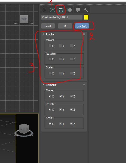

1) My ability to rotate free lights with Ray Traced Shadows with a Uniform Distribution (rectangle). I've done nothing different in my scene set-up. It's a problem even on previously used scenes. I can move the lights using the Move Tool, but I can't rotate them in any direction. All I get is the angle in the color of the chosen direction with no movement of the light (see attached pic).

For the light rotation go to Hierarchy, Link Info tab, and make sure
All checkboxes under Locks are unchecked as in the image below:
