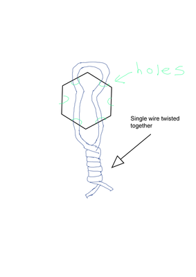

Good day everyone,

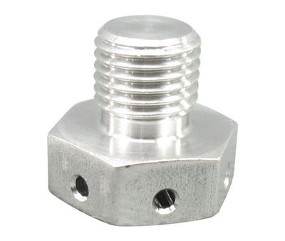

I am currently working on a lock wired animation with both of the front and back of a single wire putting thorough two different holes of the machine thread plug:
and the end result will look something like this
I need someone to give me some advise or tips on this for this animation. thanks

This will be the end product of the animation:-wirelocking.png
 Hope this will give you a clearer picture of what i have mentions above, thank you.

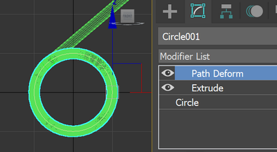

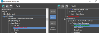

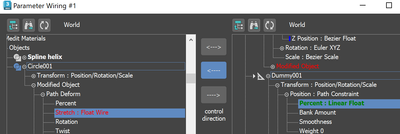

Please see the attached file.  I created a helix and converted it to an editable spline and then found its length (378mm) via Utilities, Measure.  A dummy object with a path constraint is associated with the spline.  A circle  with Extrude and Path Deform modifiers are applied to the circle. A wire parameter associates the Stretch parameter to the percent along path position of the dummy.  A separate cylinder is used for the straight portion of the wire.  The height of the cylinder shortens as a function of the position of the dummy through the use of another wire parameter.   The helix was converted to a spline anticipating the need to manipulate the spline shape to pass it through a bolt head.

Hi lee.minardi,  thank you for replaying me but from what i can see on the pictures above, it's a single line wire connected to a circle. is it possible to do an animation like this?

Although you consider it one wire the image you show can be considered as two wires.  To animate it I would consider several stages.  For example, a U shape wire passing through the nut then the helical twisting stage.  I'll give it some more thought later today if possible.

Yes for the U sharpe wire i can attach 2 dummy to both vertex points of the spline and move through the holes but it is what come after going through the hole, I need to somehow twist the wire but twist modifiers will not work in this case because it will twist the whole wire which is not i wanted.
I tried to re-crate what you did but it didn't work, this wire parameter is kind of new to me, I did what you stated but the circle will not attach to the dummy for some reason. This is only for practice, by no mean I am an animator, I am just a 3d artist but my company still require me to do so...

To have the loose ends of the wire move in space as they are positioned through the hex nuts is very difficult to manage.  An alternative approach is to create a spline that is in the final shape of the configuration you want and then use Extrude and Path Deform modifiers that are associated with a wire parameter to dynamically reveal their trajectory.  A very simple version is provided in the attached Max file.  A spline and a helix were converted to Editable Splines and then attached to form one spline.  Please let me know if you think this approach would be satisfactory.  Its implementation would be much easier.

What is the point of putting cylinder under dummy?
how do you accurately calculate the expression stretch?
How do you make object disappeared?

Please answer the question I asked in message #11.  I think it would be much easier for you to use as you have limited experience with Max
 The cylinder is used to model the wire that is not part of the twisting helix.  Technically, the dummy is not necessary as the cylinder could have the Path Constraint controller applied to it.  Using the dummy gives me extra flexibility.

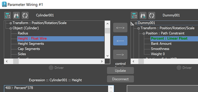

For the twisting wire I consider its total length to be the lenght of the helix plus a little more so that there is some wire left over after the twisting is done.  I don't have access to the file right now but if I remember correctly the helix is 110.5 long.  If we assume the total length is 130 then the expression for the height of the cylinder would be:
130 - percent * 110.5
At the start of the twisting the cylinder if is (130 - 0.0 * 110.5) = 130.
When the twisting is halfway through the helix the cylinder height is (130 - .5*110.5) .

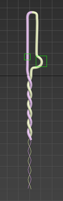

Here's a step by step Youtube video tutorial I just created of how to animate the twisting of a pair of wires.
https://youtu.be/p4ZbpTr4HdA
 You should be able to easily add a "plyer " that spins and move with the twisting portion of the wires.
As for the snaking of the wire through the nuts, I think ta good approach would be to have the end of the wire's position animate rather than have the wire dragged through the holes as you would see in a sewing sequence.
