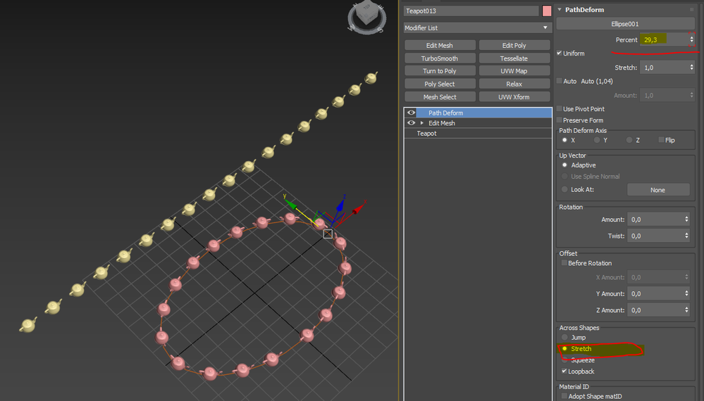

domo.spaji
It's pretty simple...
Yellow tpots lined  and attached in single mesh obj.
Rose tpots added Path Deform - setup on pic.
Message 9 of 16

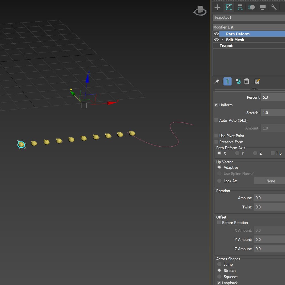

@domo.spaji Thank you but I couldn't get it to work.
I created a Teapot added an Edit Mesh modifier then used array to make 10 total instances in the x direction.  I then selected the 10 Teapots and click Attach. I  added a Path Deform modifier with stretch and got the following.
I tried several other approaches but no luck.   Any suggestions?
lee.minardi
Message 10 of 16
domo.spaji
You didn't attach them to single obj.
Don't understand how you tried it, we are talking about Attach option in Edit/able Poly/Mesh Geometry rollout.
You can not attach instanced objects or modifiers, make at least one of them unique and attach others.
Message 11 of 16
domo.spaji
Also, line should be closed (or "almost" closed) so there will no be stretching from 1st to last knot in it...
