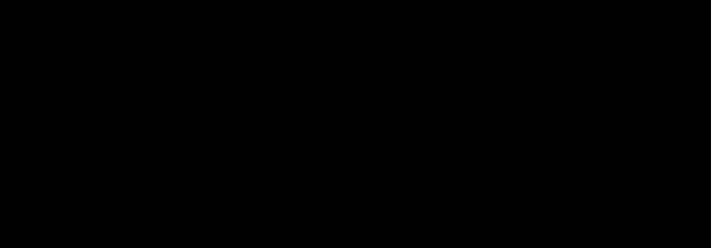

Here's maybe something better to help explain.
So as you can, as I give bone2 more influence, it's grabbing influence from both bone1 and bone3. But I do not want to to take any influence from bone1. I only want to transfer some of the influence from bone 3 (but not all the influence, just some) It's a lot of vertices I need to edit on a character.

Weight tool
may be the option you're looking for... the tool is not intuitive. It can be a problem to normalize and unnormalize to keep the geometry correctly skinned.
try to use it without being activated always deform in the skin advanced parameters options, finally activate it after changing the vertex weights
Couch_Potatoh
Thanks for all the help on this. Between the tool and using the weight box by unchecking normalize, I believe I'll be able to get it and save some time. It's not "ideal" but it's absolutely better than nothing. It just means a lot of manual editing but a lot of time saved as well with the script.
