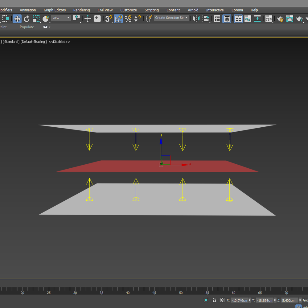

I need a force field to keep a mesh in a certain area, but without influencing its properties from the cloth mod too much.
Lets say my scene is a flying carpet and i want to keep it levitating in a natural way. With the cloth mod i want to simulate objects, for example, stones falling onto the carpet, or footsteps or whatever that impacts the carpets cloth behaviour. Then i want to move the carpet around between that certain area. Binding it like the Uconstraint of MassFX with limited transition and spring/damping on.
Accomplished that so far with the spacewarp gravity, but its only available in planar and spherical.
Need something that lets me form the "binding" area

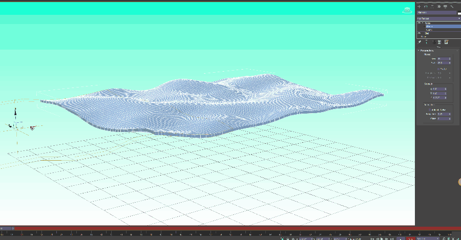

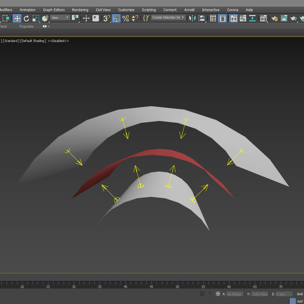

Desktop Screenshot 2019.02.25 - 11.38.00.16.png Desktop Screenshot 2019.02.25 - 11.38.11.55.png
Any other forcefield would do, if they are compatible with cloth modifier.

I did a first pass with just an animated noise modifier applied to the mesh, moving the gizmo backwards, here is the result.
Let me know if you want the scene file! I'm using 3ds Max 2019.3, what version are you working with?

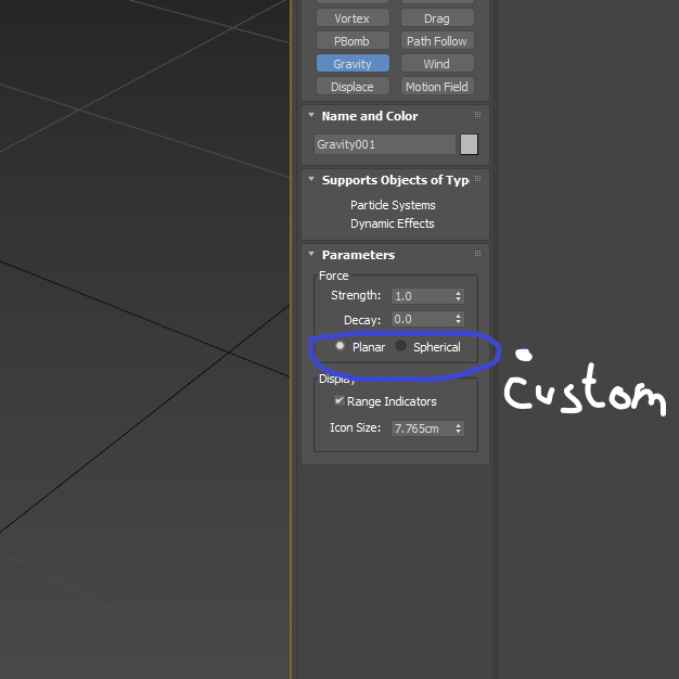

All i really need is a deformable/shapeable source of a forcefield. Or a custom button to load your shape which the forcefield uses instead:Desktop Screenshot 2019.03.16 - 15.23.36.30.png
Like the custom physical shapes of MassFx, that lets you form your own collision shapes and make the simulation use them instead of sphere, box etc. for example.

Doesnt matter for me how to achieve this. But it should be loadable into cloth group forcefield.
Tried to shape them by using modifiers on the Space Warps, but none worked.
Is there a "convert to Space Warps" or "load custom shape" from geometry option i overlooked? Or is it simply not possible to have other shapes of forcefield sources?

I don't think we have any way to shape a force field in the way you are asking. We do have a new force called MotionField which was included with Fluids. It is a generic force that works with everything, and has a geometry option, but that option is only for fluids (I'm 90% sure of that, but will test it).
Thinking out of the box a bit, you could deform a mesh in the way you want and then have another mesh that is constrained to that deforming mesh. I'm not sure if that would get what you want, but from what I understand, that might be the way I would try and approach it.

Thanks for the additional information and sample scene! As Martin said, there isn't a way to load custom shapes into a Space warp, except as noted in the Motion Field tool.

Already mentioned what i want. Shapeable force fields or loading your own mesh shape as a force field. Thats what i was asking for. And as you said, there is no way.
Motion Fields, as stated, designed for Fluids and will only work with that.

This is not entirely correct. MotionField indeed works with cloth but it`s geometry option doesn`t.
Perhaps something to look at for devs since i couldn`t make the geometry option work with ANYTHING(Fluids,Particles) .

Only thing i could do with MotionField is to load it as a Force with the Cloth modifier. But it affects nothing, no matter what.
As you said: Perhaps broken or i`m stupid.
