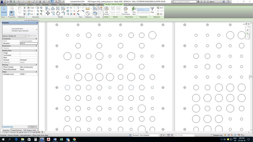

I've set up a circular void family to create custom perforated screen on a wall face. It's been working quite well (albeit a bit slow due to the number of them) and I could copy and paste the voids and and adjust the sizes quite easily. Now when I select one or multiple and change the properties to a smaller/larger void, or copy, or even insert a new one, it does insert/copy/change but will no longer associate the affected void to the wall, ie you can't see it, but when you hover over it it highlights like it is there. I've tried deleting some and then restarting, but no luck. I've tried using a computer with more memory and the same thing happened. I've tried selecting new host, editing work plane, picking new work plane, joining, cutting, etc and none will associate the void family with the wall any more so it won't cut the void out. It worked before, so I can't understand why it no longer works... Any thoughts? Typically, I was almost finished... The same thing is now happening with the reveals on the wall.

Can you upload the void family and run a quick schedule to count how many instances in the project?
Message 3 of 13
KatFish01
30 diameter - 1840
20 diameter - 1847
10 diameter - 815
total - 4502 (and we want a few more yet...)
all on one wall.

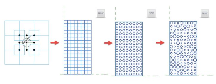

It doesn't have to be slow. You can do this quickly with a pattern-based family, with one circle, repeated on a divided surface, and with different sizes, with the help of the Randomizer tool.

Great thanks. Just trying this out. Got as far as applying the pattern to the surface which was way easier, but can't find the randomiser tool to create the different sized circles.

The Randomizer tool is an add-in; you can find it in Autodesk App Store (free) at:
https://apps.autodesk.com/RVT/en/Detail/HelpDoc?appId=6191999389973068913&appLang=en&os=Win32_64
I made a couple of examples about the usage of the Randomizer, recently, here:
