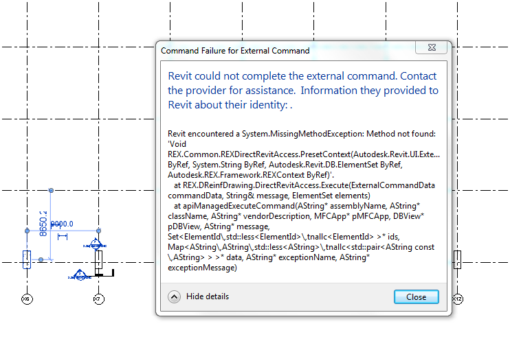

Message 5 of 10
hi,
    while i was exporting a revit file to lumion, i encountered a similiar problem. But i could not seem to solve it. ive seen replies about a transaction problem, but im not very clear about it. if someone could do a simplified explanation, i would be very grateful as i completely have no idea about coding.NEED HELP
!find the pop up in image attached.
thanks.
Message 6 of 10
RPTHOMAS108
Your issue has nothing to do with transactions. Your add-in is out of date compared with the version of Revit you are using it with.
As an end user you should get an updated version from the software vendor (if one exists). As a developer you should update the code to suit the latest version of the API.
