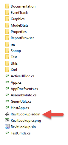

Hi Jeremy,
thank you for all you have done by developers. I'm starting with this now, so sorry for the beginner question, but I desperately searched several places and found no answer. So, where do I find the *.dll file to run the Revit LookUp tool?

stever66
I believe you need Microsoft visual studio.  The free version will do.   You use it to open the revit lookup.sln file, and then build the .dll from within visual studio.

jeremytammik
Dear Ricardo,
Steve is absolutely right. Thank you, Steve!
The source code and solution file is provided, and no executable.
You have to build that yourself.
Please work through the Revit API getting started material, especially the DevTV and My First Revit Plugin tutorials:
http://thebuildingcoder.typepad.com/blog/about-the-author.html#2
That explains all you need to know about compiling and installing a Revit add-in.
Always grab the most up-to-date version of RevitLookup from the GitHub repository:
https://github.com/jeremytammik/RevitLookup
Versions for older releases of Revit are also available from the previous releases:
https://github.com/jeremytammik/RevitLookup/releases
Good luck and have fun!

To install RevitLookup, you need to compile it, e.g. using Visual Studio or Visual Studio Express, to create a .NET DLL assembly.
With the .NET DLL assembly and the add-in manifest provided in the GitHub repository in hand, you install it like any other Revit add-in b copying the two into the appropriate Revit Add-Ins folder.
