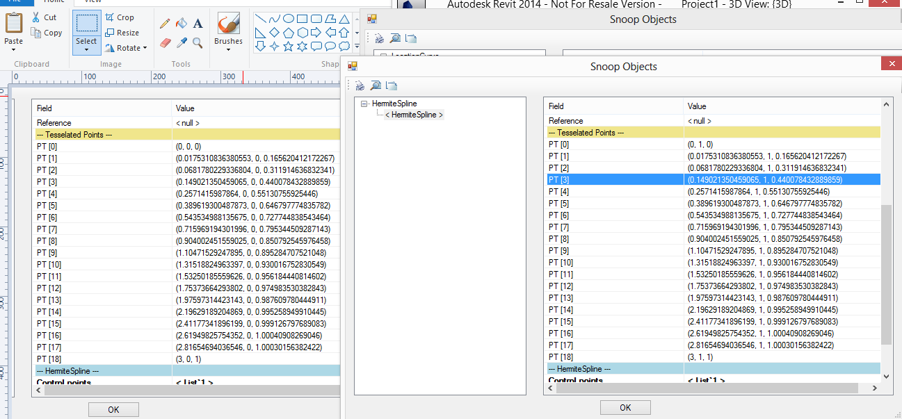

Got a couple of questions:
1) When you use tangents with other magnitudes (say 4 instead of 3) do you see Revit doing floating point changes?
2) What about when you use unit vectors, is it still approximate?
3) I am not familiar with Hermite splines so have to ask, why is the magnitude of the tangent important?
Cheers
Gopinath
GeomGym
Hi Gopinath,
I added 4 lines to the code (pasted below) to set a similar pipe with a tangent of 1 (instead of 3).
1.  No noticeable floating point change to the inplane coordinate.  Image below.
2.  Aproximate to what?  I posted the spreadsheet showing the variation in shape.  A change in tangent magnitude should significantly affect the shape of the spline.
3.  I'm not so familiar with hermite splines either (hence the google references above).  It's a curious choice given every other software seems to have opted for nurbs.  I'd like to accurately and reliably create and extract geometry with Revit.
I look forward to hearing further expanation about the way Revit provides API access to this geometry.
Cheers,
Jon
