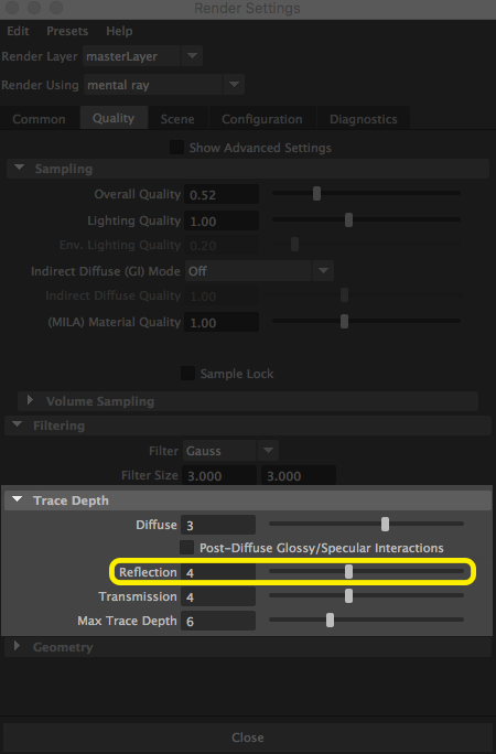

This was originally going to be a question but it seems to be fixed in my scene now, after going to Render Settings > Quality > Trace Depth > Reflection and changing the value from 5 to 4. I thought it might be helpful to share if anyone comes across a similar issue so here are the details anyway:

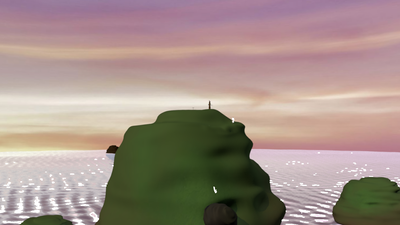

  • What the dots/pixelled areas look like, compared to what was expected:
(1a: unwanted white spots)
(2a: white pixelled areas on ocean)
(1b: what was expected)
(2b: what was expected, no bright white areas on ocean)

I have four lights in the scene -- an ambient light and three spotlights and most of the white spots seemed to appear on the ocean shader in my scene but I didn't get a chance to test and record the effect when I turned the ocean shader off.

  • I noticed that even after redoing the same render, the position of the white spots could change but they were in the same general location -- they appeared in areas of highlight.
 (GIF comparing a redone render from same angle, same frame, but white spots are in slightly different places)
  •  Sometimes changing the camera angle by a bit would stop the dots from appearing, sometimes they still remained in the same general location as well.

Solution that worked:
(I changed Reflection from 5 to 4, a much quicker fix than I expected.)
I am not sure why I had it at 5 but I compared to my teacher's settings which had the numbers at default, and I tested what would happen if I changed it back. It not only got rid of the white dots but seems to takes less time to render too.

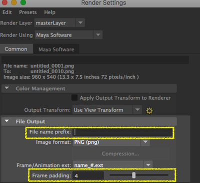

Script for saving frame that has just been rendered in Render Window:
There are two things to set: the prefix of the name of the save file, and the frame padding.  These options are the same as in the Render Settings:
The script defaults to the image format you have set in the Render Window. In the MEL script, I denoted where to set them with // >>> If anyone does happen to end up using this, I would be more than happy to help out with whatever I can but I don't want to dwell on it too much 🙂 A quick tip, to run these go to Windows>General Editors>Script Editor and paste them in the bottom window.
