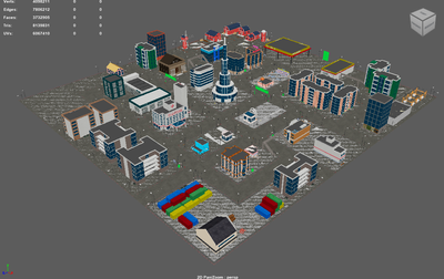

Hello, may i please ask, WHY the materials always do disconnect ? what is the reason ? the project is being modeled on my own pc, i mean what is the problem ? the reason for a Material to disconnect ? let's say a Texture well, maybe Maya lost it and forgot it's location, but Material ? and what is the solution ? please no youtube videos for help, they don't help
