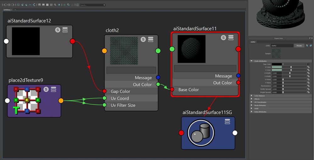

I'm having an issue rendering Maya 2D texture cloth. I'm trying to make a net using the 2D texture cloth and I want the Gap Color (now in black) to be Transparent. How do I achieve this?Net.jpgshading_network.JPG

stigla
It works if you connect outAlpha to opacityR, opacityG and opacityB.
BUT, common. PNG should be suppoted automaticaly.
Please !
Thank you

adebiko3000
Wow. This worked for me! Thanks a lot!
