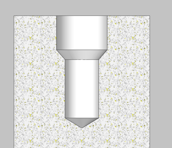

Add functionality for the user to add a second (possibly an endless number as dictated by the user) counter-drilled hole while in the hole dialog.  This would be different than the spotface and counterbore options as the counter-drilled hole has the same (well, almost always, IMHO) drill point angle as the main hole.  This would save quite a bit of time as opposed to having to 'drill' a second hole right after you've placed the first (provided the hole notes were also smartened-up to recognize both holes).

There's a fifth type of hole which is sometimes used in woodwork. It's a countersunk-bored hole. You simply use the coutersink bit to bored down into the wood after coutersinking the hole. It's used when hiding screw heads with wooden plugs. It's similar to a counter-bored hole feature except that instead of a flat bottom for the boring, it's an angled bottom, the same angle as countersinking.

mcgyvr
@kstate92 Please confirm that you are talking about something like the attached image..
I would call this a recessed countersink..
I think this image may help with the vote count too so your request is very clear as to what you mean..
