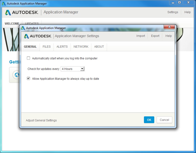

Message 19 of 20
There's a simple solution to this problem.
Run Application Manager as admin -> Settings -> Uncheck 'Automatically start when you log into the computer'.
This will stop the error popping up at start up.
Message 20 of 20
n.schotten
I would not call that a solution. More a disabeling that stops the use of the program, for not many would manually start it after boot up.
A solution would keep the program running without generating errors.
