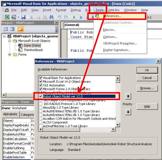

Hi
Go to VBA Editor (Alt+F11), go to References, unmark Robot Object Modeler, close References window by pressing OK, open it again, select  Robot Object Modeler ver. 12.0., press OK
Rafal Gaweda

I´ve tried your solution on the problem, but it still gives the same error message.

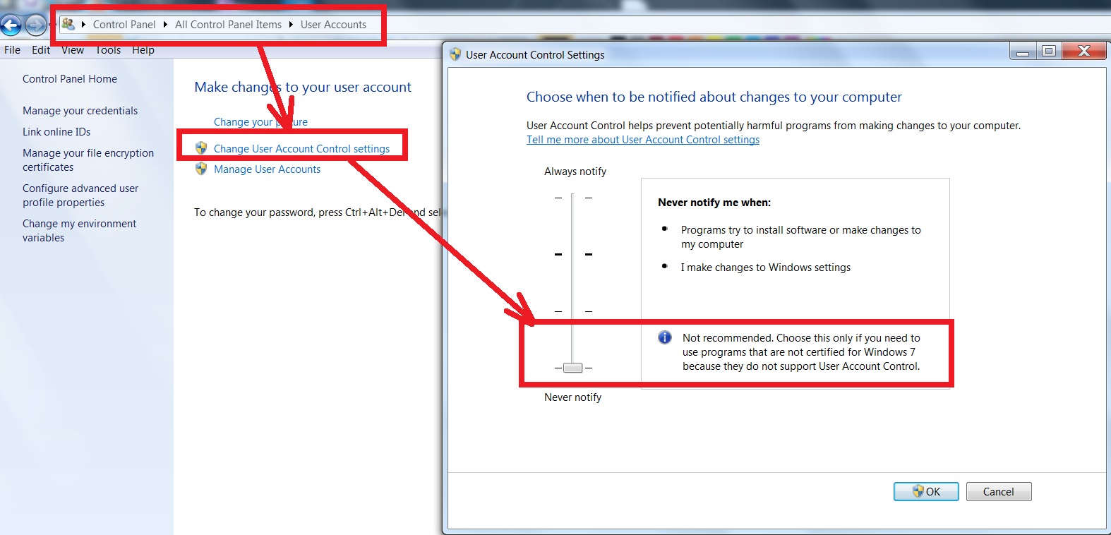

Try:
1. Run Excel as Administrator, run Robot as Administrator, then check macro
2. Check \ set UAC :
Rafal Gaweda

This gives the same error.
