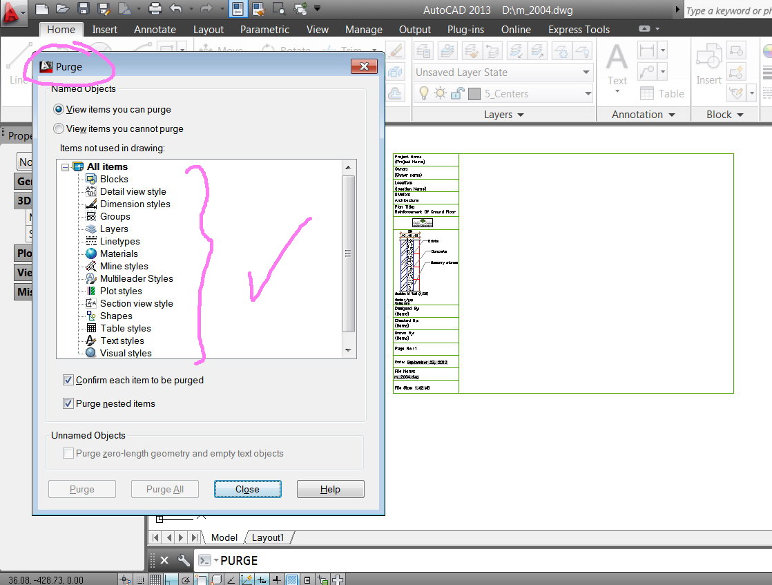

JamaL9722060
Many thanks for the answer.
I’m attaching the dwg file with version 2000. I purged but the problem persists to exist.
What might other solutions be?
